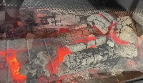

I seem to found a way to properly start those "overnight" fires, so having air control almost closed, it looks like this:
It continues like that for about 2-3 hours with properly working secondary burn and no smoke from the flue. But then the fire disappears leaving only glowing stuff looking like this:
[Hearth.com] Overnight burn: second half no fire despite perfect first half - normal?
Because of this overall temperature drops, secondaries stop working and smoke appears. So at this point I have to open air control to get the fire back. But if it's an overnight burn, obviously, I can't do that. So very often in the mornings I just find a small bunch of lightly glowing coals left and the glass sometimes pretty dirty since the fire disappears early.
My question is: do you guys have it like this too? I would think it might be due to the not properly seasoned wood again, but it looks pretty nice in the beginning few hours, so I'd think it should continue like that... But it doesn't...
Thank you.

Well, with the experience I have by now (2 months of burning :)), I can certainly say that I'd never tell by a photo which air setting is used, because it really depends on the wood (how well seasoned is it). Sometimes "air" is fully open and there is barely any fire, looking as if the air is almost shut. But regardless, I think that tendency of temperature dropping after few hours and flames disappearing because of that - is there. Therefore, when fully loading during the day, my process now is the following:
  1. Start the fire, leave the door crack open and wait for a roaring fire. Very much depends on the dryness of the wood, but on average about 10-15 minutes.
  2. Close the door, air fully open - wait for full box of roaring fire with "bricks" formed on the logs. At that point the stove is pretty hot, so the secondaries can work.
  3. Shut the air about half way (secondaries work beautifully when I do that ), then give it another 10 minutes, then shut as much as possible for the fire to be there. How much fire depends on the outside temperature, obviously, but most of the time it's minimum amount of slow and blue-ish fire.
  4. At this point I'm simply maintaining that fire. In few hours it starts diminishing, so I have to start opening that air back little by little if I want that fire to be there as much as possible.
  5. At some point the air is fully open again, then the last fire disappears leaving only glowing coals.
I'd have the same process for the night if I was making frequent trips to the stove, but I don't want to, so the fire disappears earlier...
That's how I see it at the moment. When I just started this year, I tended to shut the air too quick, because I wanted that "long overnight burn" :) So my glass was very dark every time this way and stove temp was not high enough to make secondary combustion happen. Now I rarely have black glass, mostly when logs are very close to it.
