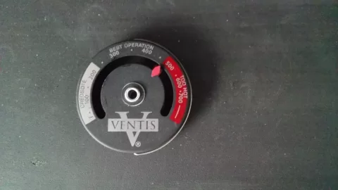

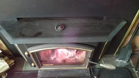

840° on my stove, per the manufacturer, at the the hottest spot on the stove. It's generally on top in the middle, right in front of the hole where the liner attaches. Probably inaccessible to you if you have a face plate over the surround.What temperature is considered over firing?View attachment 233625This is the temp of my stove right now. The thermometer is located on top of the stove above the door. Is this the right place to put it?

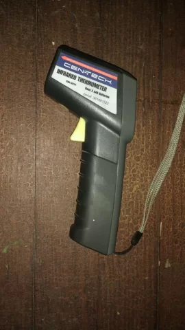

I recommend an infrared thermometer that would allow measurements around the door. Just point the "laser beam" (sharks not included) where you want to measure. They are cheap and nice to have. I've found measuring around the door to be a bit cooler than the hottest spot.
If you read 840, it's been over fired, so you'll want to keep it down quite a ways from there. I start to worry a little at 700.
Over time, you'll begin to recognize when you are headed there.

Your stove is safe to take up to 700º on the stove top.
840º is right below the temp where the steel will start to glow red. At that point the metal in the firebox will be exceptionally hot. While 840º may be in the mfg. listed safety zone it will be pushing the stove which will increase wear and stress if done many times or over an extended period. 700º is a safe and practical limit. If the stove occasionally peaks a little higher it's ok.

I think you have your answers: aim for below 700, and get an infrared thermometer ($20) so you can check out all the different spots, to learn.View attachment 233875 View attachment 233876 This is where I have it. Right in the center. The chimney guy told me to out it there. I would like to get the infrared gun and see what temperature I get.
