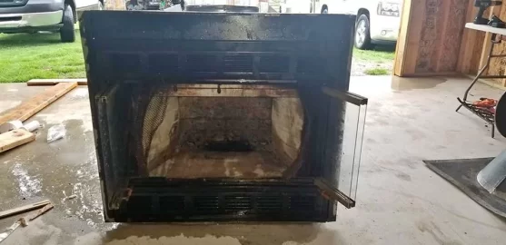

After searching through the old forums, looks like people have put inserts in this exact ZC. Will do some more research to make sure.
![lol ;lol ;lol](/talk/styles/default/xenforo/smileys/lol.gif)
Out of curiosity, what is it then that you suggest?Yes I am sure they have but in doing so they violated code and opened themselves up to massive liability. Read the manual for your fireplace that I provided. No additional research needed.
Either a freestanding stove elsewhere or tear out that unit and replace it with a high efficiency unit. You can also tear it out and build an alcove for a stove.Out of curiosity, what is it then that you suggest?
Also that manual was written over 30 years ago, couldn’t there be manufacturers that are now approved for this model.Yes I am sure they have but in doing so they violated code and opened themselves up to massive liability. Read the manual for your fireplace that I provided. No additional research needed.
Only if majestic has restested the unit and issued a revised manual. Do you have a revised manual?Also that manual was written over 30 years ago, couldn’t there be manufacturers that are now approved for this model.
I think you know I don’t have any manual considering I struggled to even find the name plate. Was just asking a question that seemed logical. Thanks for your help.Only if majestic has restested the unit and issued a revised manual. Do you have a revised manual?
I am sorry that I had bad news for you and that your stove shop mislead you. I am just telling you what is actually allowedI think you know I don’t have any manual considering I struggled to even find the name plate. Was just asking a question that seemed logical. Thanks for your help.
I can understand that, but it's doubtful that you have the clearances to combustibles required by the insert, regardless of any of the other factors in play..Was just asking a question that seemed logical.
I would contact the manufacturer of the ZC and see what the say. Bholler may have some insight on this.That is not a comforting sight. Unfortunately, we don't know the history of the ZC. The homeowner could have been pushing it hard, burning 24/7 in it before the insert was put in. Many ZCs are not designed for that type of operation. This could have been when the base was scorched. If so, the heat from the insert bottom was probably much less than without it. Moot point though, if pyrolysis had already started.
