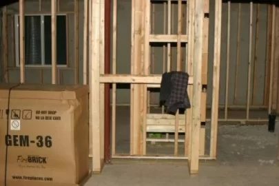

The mantle clearance is measured from the top of the stove, not the stovepipe. The manual says 30 inches, no less. I will try to find a copper one if I can, otherwise i can get a black one from my dealer.
Interestingly enough, the manual does not in any way imply that the stove can be installed into the prefab fireplace - as you have probably seen, it specifically addresses masonry only.
I know Jotul has oked this before if all clearances are met, and with the read heat shield you are meeting them. That's good.
My problem with this stuff.....which is off-topic in this thread - is that people will see it and think that most any stove can be installed in front of most any prefab. In most cases, this is not true at all. Anyone thinking of doing this better have all the I's dotted and T's crossed......and, of course, clearances maintained.
As eight suggests, there is combustible wood in the wall all around these fireplaces and the stone face does nothing to reduce clearances.

The only reason my stove fit was because the old majestic ZC was soooo big. The width of the metal prefab opening was almost 50" between combustables. My stove only need 9" on either side to meet the clearances, as long as I used the rear heat shield. We will see this winter how hot it gets along side the stove. I can always make some heat shields for the side if it gets the stones too hot. 8
