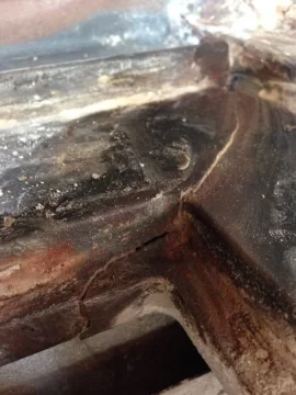

I clearly understand where my shortcomings were. It was, in fact, my error to be made. And I made it. Even being a well experienced burner with years of stove use. Using the ash pan door numerous times....Its that one time that gets ya.
Have you ever had a car accident that was your fault? I haven't. But I screwed up using my ash pan door.....

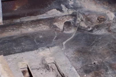

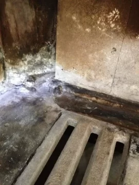

Opening the ashpan door does not evenly heat the firebox. It tends to heat the back corners of the base of the firebox where the grate rests. And it heats them much more rapidly than the surrounding metal in those spots. This forge-like temperature in a small location causes cracking by differing expansion of the metal.
Fire starting with good kindling is easy. There is no reason for risking costly damage here.
