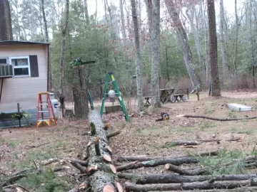

I dropped an 80' loblolly pine today, that had dropped branches on my roof and was leaning over my mobile home. Ran a 100' of steel cable from 24' up the tree to the hitch on my 4x4 truck. I cut my notch and then put some tension on the cable. Started to make my felling cut and the saw sputtered and died. Grabbed my second saw and finished the cut, dropping the pine right where i wanted it. Not the first time a second came in handy. I never cut without at least 2 saws. Changing bars isn't always an option.

Nice pine, hope you are going to burn it.
I have two saws for the reason above. If you don't want to spend the $$, get a second bar and chain.
Do but yourself a pair of chaps, hearing proteciton and eye protection. The chainsaw chaps could save your leg.
I'm giving the wood to a neighbor. I've got enough wood cut to last me 3 more winters now : )
