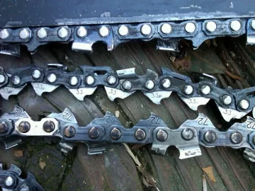

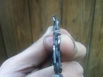

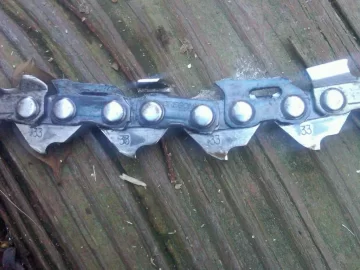

ok, an update. i posted some pics of the old and new chains, don't know if it's useful or not. however, i did figure out why the old chain wasn't cutting. the raker comes out to the side of the chain, effectively blocking the cutter. on the last pic, you can see that the cutter doesn't extend to the left past the raker at all. not sure if the rakers are bent sideways (looks maybe a bit more than the new chain), or if the cutters are just worn down too much to be sharpened. and the chain is just junk. is that the case, or is this damage/salvageable?

Mike,
That middle chain marked 33 is a safety chain. If you're gonna keep running it, grind the bumpers down a bit when you file the rakers. The stupid things work OK untill you get to a certain point of cutter length, and then they throw the angles all to crap and wont let the cutter tilt and get a bite behind it. Looking at the pic in the middle, it looks like the rakers have never been filed, one raker is busted, and the drive links are starting to get peened a bit.
The chain with the 72 stamps on the drive links, is the dreaded "Vanguard" with the folded over rakers. They are a PITA to deal with when setting raker height, as ya can't get any gauge on them, and they don't file for crap. Have the shop grind them for you or join hair club for men...cuz you're gonna pull yours out dealing with the things.
Honestly, I'd pitch both, or grind them and keep them for one last use on some nasty filthy stump, then pitch 'em.
Looks like you have Oregon LP/LPX on the bar, it's decent stuff, even with the bumper links, and should be a LOT easier to maintain with a simple file and gauge.
Just be mindfull of keeping good habits concerning kickback.
While you're tinkering, put an eyeball on the rim sprocket. Both of those safety chains have drive links showing some peening. Either they were run loose or you might have a worn sprocket.
thanks for the insight. chain #2 (the pic with the solo chain) has had the rakers filed. all 3 chains came with the saw, so I don't know what kind of use they got. as far as the "bumpers", what exactly are they? is that just the protruding part of the raker? i'm going to get rid of the vanguard chain regardless--doesn't seem to fit correctly. weird that none of the sharpening guides that I've found mention this type of wear, and that it's something to check.
Mike,
The "guard' links on the s series chain in the middle pic. They keep the cutters from digging in enough to cause a kickback.
Somebody lowered the raker to be correct for the angle on the short cutter, but left the rest of the cutters and rakers the same length.
Sorry about the cornfusion. The Chain on the bar has the "Bumper link". It's a drive link with the little gizzie that rotates forward on the bar nose radius, reducing the bite of the cutters as they pass over the KB zone of the bar nose and making them a safety chain that is still tolerable.
