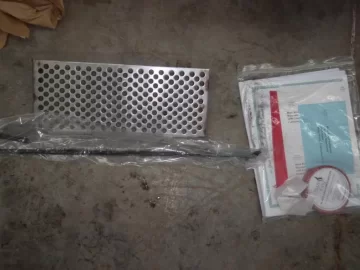

Prolly still sitting on the pallet. I saw a couple used Cape Cods sitting on the factory floor. Not sure their history but was wondering if one was yours.Travis Industries still to this day will not accept the fact that the cape cod has a flawed baffle design. I've personally talked to the engineers, in person. They act like they have never heard of any issues and said that they aren't aware of any cracked cape cod stoves. I sent the stove back to them but the engineers never saw it. Ya right!
The insert has a different design so I don't expect parts to warp like the free stander but I still don't see how that catalyst can hold up under these conditions. Why would they make the baffle way beefier in the insert if the free stander hadn't had any issues? Hmm...
Even the manual shows the raw exposed cat. If I owned one of these stoves I would have a stainless steel flame shield fabbed up.
