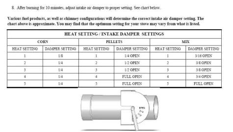

here is the damper settings
As in your manual page 9

Yes I've read the manual. It's sitting next to me at the moment. Yeesh.
Kozy said regardless of the chart, leave it 1/2 open and play with it as need be. I'm not entirely comfortable playing with it without gathering more knowledge. That's why I'm here.

The above setting is on the intake air.

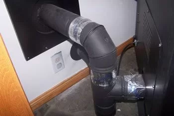

photo 1: Shows the rear piping.

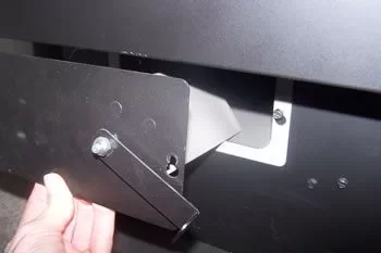

photo 2: shows this mysterious damper/handle...it's located just before the exhaust fan.

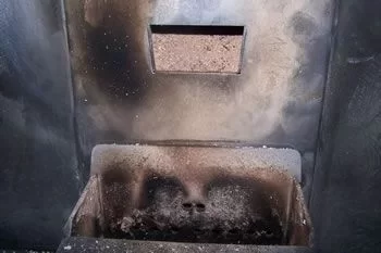

photo 3: show the burn pot after ONE burn at the lowest setting for less than 15 minutes.

But I call tell from the photo you are not getting enough air and or that 90 deg in your vent with a direct vent install is giving you problems.
a 90 deg elbo in a run is = to having and extra 3 or more feet of horizontal pipe.
does it look like there is a rise in the horizontal pipe?
Open that damper a little and try it.
if it is better open it more.
There's no rise in the horizontal piping. :(
When you say open the damper, you mean that mystery one that kozy added, not the intake damper, right?

As long as it is not going down hill
but the correct way is 1/4 inch per foot
so if 3 feet of horizontal then 3/4 difference from the top of that 90 to the end of your pipe in rise.
yes open the Exhaust damper a little
It would not hurt to tweek on the Air intake damper also as it is burning to get a more intense flame
