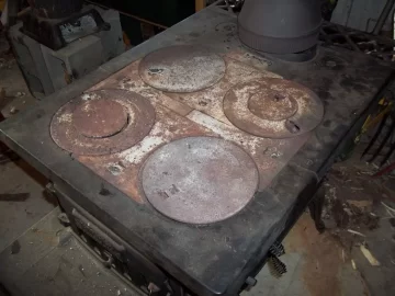

The top is normally seasoned like a cast iron pan with cooking oil. It should be wire wheeled and sanded smooth down to clean metal, and a few fires with oil each time applied until a black coating forms from the oil. Oil again when not in use for long storage periods.
Reconditioning top;
![Old Wood/Coal Stove Turning White Old Wood/Coal Stove Turning White](https://www.hearth.com/talk/data/attachments/98/98398-6c56a8e19a90bce3dcaf191df555b599.jpg)
Seasoning top after first fire. Yes, it's smokey when seasoning.
If it flakes or wears off in spots, reoil. Once seasoned, you will smell it if it gets too hot.
