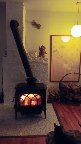

Hi all,
Just came here to say thanks again for everyone's help getting us set up! Year number two of heating exclusively with this stove and we are in love (and so are our two cats). The F500 is the perfect size for our house and is working beautifully! This year we're mostly burning mulberry and a little white oak, and we have a lot of locust and even about a cord of osage (!) in the wings for next year.
Just wanted to update since this community helped me so much!
(Sorry for bad lighting, my phone stinks)
