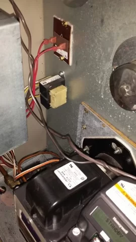

yesYou mean to disconnect the T-stat connection and put a jumper across the terminals?
does you furnace have this control
if so take off the cover and watch it se if it moves right. watch it from cold. pull it out and look at it see if there is and buildup on it.
