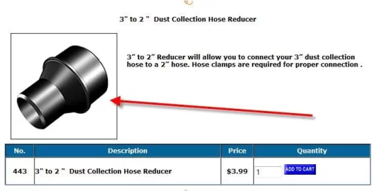

I have an issue with the oak, i used the 2” metal flex pipe (came with the stove) from the stove thru the back wall which happens to lead into the inner wall of the garage, i don’t feel comfortable having it draw the garage air, so i would like to extend it using pvc to the front of the garage wall, so that way it will draw outside fresh air, length would be around 15ft the stove manual says any thing over 6' needs 3" pipe but i have already used the 2" oak kit and the wall plates will not accept a 3" pipe, IMO i only have to adapt the end of the metal flex from the stove to the pvc (not sure what to use there?one member said to use a metal dryer vent adapt), what do you members think? any feedback and advice would be greatly appreciated.
