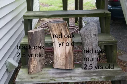

I took one split of Black Oak, 2 1/2 yrs old. One split of Red Oak that was 1 year old and one round of Red Oak that is 2.5 yrs old ( only Red Oak I had that old ) and measured the moisture in them.I tried to pick close to the same size. All exposed to the same drying process. Top covered with rubber in the sun and wind. I brought the wood inside for about 4 hours before splitting them. I used a cheap Harbor Freight meter.
The 2.5 yr old Black Oak came in at 12%, OH YEAH....The Red Oak round 2.5 yrs old averaged about 24%, guess because its a round. It was really all over the place. One end was about 20%, the other end which had a big knot on it was as high as 26%.. The 1 year old Red Oak came in at 23%.....
I'm sure I could get a better average by testing a few more of their brothers and sisters in the stacks, but, I just dont feel like it....
Note: Your results may vary .....

That 1 year red oak split is exactly what I got. The 2.5yr old red was definityl that high due to being round, and that's also why the one end was so low as well.

Not real sure why you are checking the ends for moisture?
Sorry. I see how that could have been mis interpreted. I meant "towards the end" , not the very end. Like 4 inches from the end. Still the inside of the wood.
