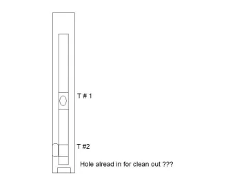

I had a hearth dealer come to my house and is going to give an estimate on liner install. They showed me ther plan which inclued 2 T's in the chimney. Will be installing an add on furnace into chimney in the basment not sure why would need2 T's or how to clean them as there are no doors on chimney thanks for the help

OK, I see a picture added, that helps. Now we can at least speculate. It looks like there is an existing cleanout door at the bottom of the chimney correct? If so it looks like the upper tee #1 is for connecting the stove and the lower tee #2 is capped on the bottom with another cap on the clean out door side. I'm guessing that the intent is to allow the flue to be cleaned with removal of the lower tee's cap through the cleanout door?
The opening on the bottom has no door just an opening and not very big only about the size of a brick maybe just a little bigger. I am sure the first tee would be for the furnace. Would it be better to put a small hole to remove the bottom of the first Tee?
