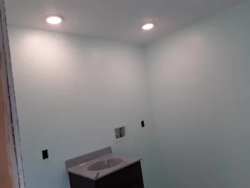

Finished sanding over the weekend and did some sanded primer yesterday. Today I am going to get the rest of the wood piles cut up and moved as there is rain forecast off and on for the next week and a half. Hoping to be mostly painted by the time the wife and boys come up Memorial weekend. Expecting to not be up much in June due to other "things".
