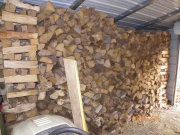

I'm also a newbie, and my shed designs were almost as good as yours:
As you can see, it's taller than me and pretty wide.
Any input would be greatly appreciated.
This was my shed a few years back before my wife made me fill it up with wood.
