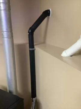

Ssyko and I are talking about your fresh air intake piping, go bigger and and use 45 degree elbows instead of 90 degree elbows

lol you read my signature. thats good! but i was actually referring to the OAK set up you have, to go larger pipe and 45's instead of 90's

So 2-45s spaced apart are better than 1-90? I need it to go straight down so it can get to the back of the stove, I actually thought your zig was a comment, lmao.

I'd use two 45s or a single 90 instead of 3x90s. You could paint the piping too, maybe go with 2.5 or 3 but as it is, they figure in extra length for each elbow and you have three where 1 will do.

Going to get it changed today, I was trying to sort of hide it, that’s why it is that way, apparently I made the wrong decision

Nice! Looks alot better and i bet it will breath better to.
