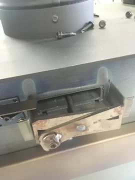

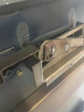

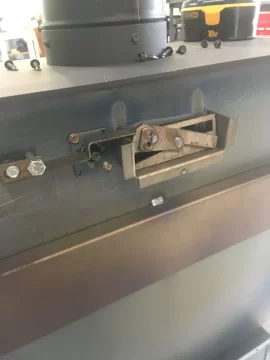

Edyit, I’ve played with it, I even pulled the rear cover off of it to see what makes it tick.

yeah, pretty much identical, i like it, pull it out to where you want your low air set at, quarter turn counter clockwise and walk away
I have both. Madison and the big brother. I am planning to install the Madison when finish the shop. I do like the AAS. To use it on reloads is better to let the stove lose temperature with just enough coals to relight. On hot reloads don't work. BTW, that's my experience.
