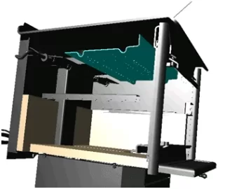

As far as the burn tubes the Myriad has none... As you can see from the drawing it has a thick stainless steel baffle with indents and enough holes to ensure your secondary combustion.

  • NEWBIE.... recommendation question DROLET MYRIAD or ENGLANDER 30NC?
