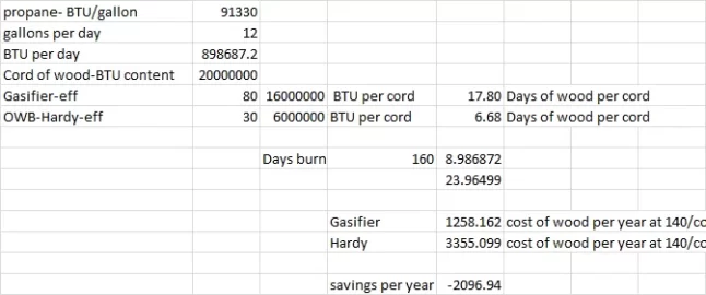

![[Hearth.com] Newbie advice sought. Looking to replace forest eater... [Hearth.com] Newbie advice sought. Looking to replace forest eater...](https://www.hearth.com/talk/data/attachments/128/128418-b7b705fc7840c34b9f576d5d3ebbb4a3.jpg?hash=R8hHymAMbn)
