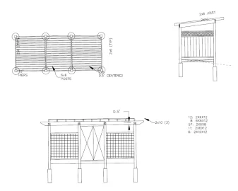

Awesome. Thanks for the info. How many hangers did you end up using? Hard to tell from photos. Obviously they have to support a good deal of weight.
I started with 8 hangers for the 2X6's running between each post front to back. Two blew out when I was loading the Oak Blocks. I talked with the Lumber Yard that I got my materials from afterwards and was told they got a bad batch of hangers (???) and others were having the same issue.
I ended up placing 2X6's behind each post and on top of the piers timber locked them to each post. The 6x's running between the interior posts
were doubled up, (may want to do this on all posts) and built the joists in place 6" on center due to the weight. Have had minimal sagging.
See if this helps

Oh man, that's a great plan drawing! I'm going to try to make something along the same design as yours and Fireman Jake's. Thanks for the great info!

One thing that I did was after the piers were poured and ready, instead of using post anchor brackets I drilled into the concrete and epoxied
No. 5 rebar into the piers. Drilled holes in each post and set them. Saves a bit of coin

Currently planning a similar shed construction, if you would please, what are the overall dimensions of the floor / footprint as well as your front & rear overhang? My neighbor has issues with snow sliding off his roof then as it piles up on the ground falling into the shed and onto the firewood. Mind you we only get about 300” a year.
