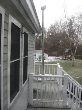

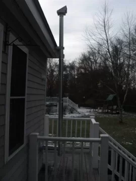

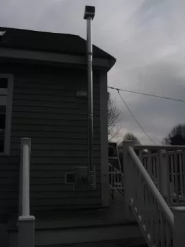

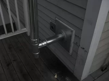

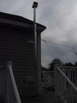

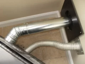

hi all.had a busy weekend here as you can see.i started from scratch an stripped out all the old venting cause i guess my EVL was off the charts at 25. i have a 45 directly off stove,3ft horizontal thru wall which brings me off the house an additional 8 inches which gave me the clearance to get by the soffit.from T i have a 9ft vertical run and cap.which cap is better ,this one or the old one .it,s amazing what i've learned in the past week from this thread,from cleaning,venting,problems with motors and the shop vac trick.nice to know you guys are always availabe. your wealth of knowledge is greatly appreciated by me and i'msure countless others who are relatively new to this pellet stove stuff.i'ts a far cry from the turf bogs i was used to.
