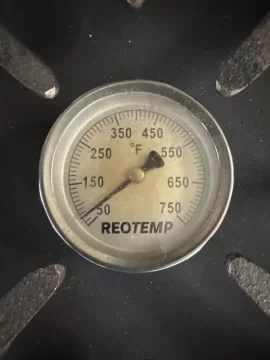

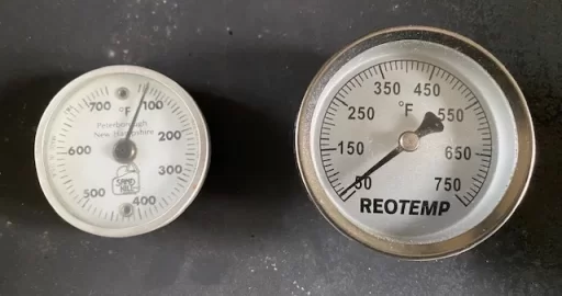

It’s getting yellow after a year, but still accurate. [Hearth.com] New stove toy - Reotemp thermometer
I got ours a few weeks after. So far it's ok but I see a hint of yellowing. Our 44 yr old SandHill thermometer is still white and accurate after all these years.

Even after adjusting mine it’s way off and very slow to react. It reads low at higher temps and high at lower temps about 40-70 degrees.
Mine tracks pretty true. You might send it back and get another one exchanged. They are for industrial use, so they should trade it I would assume. I’ve never looked into the policy.
Looking for updates. I need to replace mine. It has worked fine, but the glass was starting to yellow. I went to do some stove top cooking and lifted the thermometer. The magnet stayed on the stove, and the dial came up with my hand. The only thing between them was a spring I was pulling on before I knew it.
I took it all the way apart before I put ot back together and adjusted it. I think it’s working fine, but want to shoot some temps. I also emailed ReoTemp to see if they warranty against the glass yellowing.
Anyway, I want to hear how yours is holding up. I’m trying something different this time. In the name of research, I just ordered a different brand of industrial thermometer.
This one has the more traditional looking back, and the magnets are not attached to the spring housing. You can get three different ranges, so I suppose you could put the 500* one on single wall pipe.

Just checked temps. I royally screwed that one up. It’s not tracking at all now. 250 reading, and the IR is almost at 500.
Pro Tip:
Don’t stretch the spring out 6”🤷‍♂️🤣
But you can see in the past, I may have abused it a little too.
Ours is still ok. Is it the glass that's yellowing or the white paint on the dial?
It was definitely the glass. I had it all apart, and the glass is yellowed, and has some etching on it from where the center pin for the needle rotates on it. The metal face of the gauge itself looks brand new.
I do like the clean look of the white face and not having pre labeled “zones” that don’t correlate with what I’m try achieve.

Well. I was hoping that it would be better. When I opened the box it was roughly showing the room temperature. I plopped it on a 500 degree ST and it peaked way too low. I monitored it for a bit and the stove slowly fell to about 415 and kept dropping as the coals broke apart. The new thermometer seemed to stay about 100 degrees low. Maybe I shouldn’t have put it on a hot stove and shocked it, maybe it’s off. Shouldn’t be that bad off if it came from an industrial testing equipment supply house. Looks cute though.

I’ll watch it for a while and see if the stove was maybe just dropping faster than the thermometer was climbing or something, but it did track downward with a cooling stove, 100F lower than IR.

Getting it dialed in pretty close. It’s kind of tough given the lag that a bimetal spring has, and needing to catch a time when I have a steady stove top temp, but between a pair of gloves and channel locks, we are getting real close.
