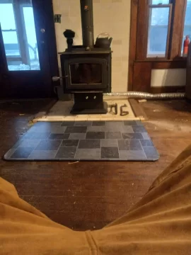

Is the stepped heart surround framing wood or brown tile? It looks sharp, but if wood, my concern is that it doesn't offer the required 16" protection measured from the stove door.
Yes vg3200 p dunno where I got 5 cu ft from sorry. I measured it and it came out to roughly 3.2 cubic ft. It actually seems better built than the 2021 2k sq ft model we had. And yes it is wood surround. Was fine with the smaller stove. I will need to address that for this one.

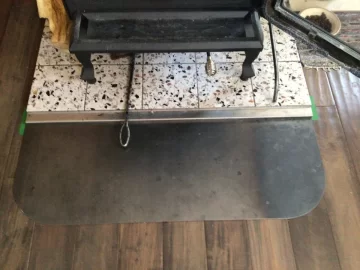

I had the same too short hearth issue when we got a deeper stove. I had the tile and everything else on hand but didn't want the little toe banger step as it would have protruded into a traffic area. I simply used a piece of "mill finish" galvanized steel to extend the hearth. I got a local sheet metal place to make it and a tidy transition piece too.
We didn't know what colour we wanted it, so we didn't get it powder coated (the local outfit does that too). Good thing, because we like it unfinished.

just an idea for you..
oh, and there's no wood under the little "z" shaped transition metal

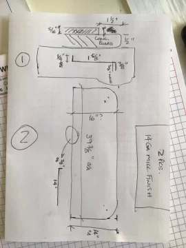

It's an idea anyway. It keeps a low profile on the floor.
I just realized I attached my crappy, chicken scratch drawing..I made a better one for the tin man.

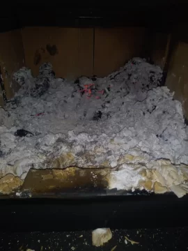

Ok. Did first full load this morning. Loaded up at 6am. By the time I left for work at 830am stove room was at 87f. Come home at 530pm. Outside temp 36f. Stove room at 70f. Probably 20 degrees hotter than what the old stove would have had. So that is good. Got class 2 hearth pad for front floor protection. Will retrim it at somepoint.

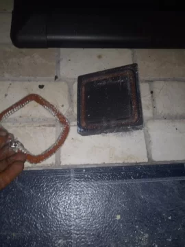

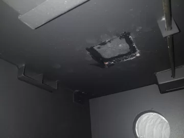

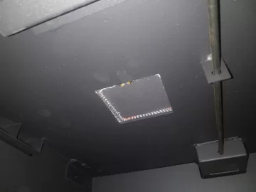

Now the bad. The one thing I don't like about this stove is the ash plug. It is in the center of the firebox and in my opinion I wish it didn't have one at all. I must have knocked the ash plug a little loose at some point because I pulled it tonight and the gasket fell off. So I resealed it but want to come up with a more permanent non removable fix. My only other concern is that this stove seems to breathe quite easy. And I'm a little concerned it will get to hot on me once temps drop down to 0 again. It was 40 this morning when I left and my single wall flue thermo was reading 350 with both air levers shut all the way down. Maybe it was leaking around ash plug?
The middle picture is what I had left after a 12hr cycle. So I'm hoping most days I can do a full load every 12hr or so and keep the house above 55 on this schedule

Honestly I would just seal the ash plug shut. I find them completely useless
Reactions: Rickb
I was going to suggest sealing it on the underside and then putting a cut piece of firebrick to fill the gap on the firebox floor.
I'd still cut a piece of firebrick for the hole to keep the temperature down on the rtv. If it gets over 500º it might get stinky.
I might not have had the cajones to leave a loaded stove before I had run it for several burns to have a good idea how it's gonna act. But maybe after a couple hours you could get a feel for what was going on with the burn. Especially if the load was lightweight wood which would do quite a bit of its gassing early.
A hinged door like the Buck 91 has is surely better than a plug. It was off to the left side so I could sweep the whole mess left over the door with the edge of the shovel, sweep the big coals back right to save 'em, flip up the door and sweep down the ash.
Nice-sized 3x5" door, not like the dinky thing on the PE. But even though the ash pan was gasketed, I could tell there was a little air getting past it.
A hinged door like the Buck 91 has is surely better than a plug. It was off to the left side so I could sweep the whole mess left over the door with the edge of the shovel, sweep the big coals back right to save 'em, flip up the door and sweep down the ash. Nice-sized 3x5" door, not like the dinky thing on the PE..
Hey, stop picking on my ashhole. ;lol Aw, might as well, I haven't used it in 13 yrs.
I would like to. But this plug has a teat with a hole that sticks up I'm guessing for hooking with a poker. That parts about level with the firebrick. I'm assuming that's how I knocked it loose and it was running so hard this am. Maybe in warm season I'll pull the plug and torch off the teat at work so I can put a firebrick in there
Yes, that's work. An angle grinder might be faster.
I Maybe in warm season I'll pull the plug and torch off the teat at work so I can put a firebrick in there
Or groove out the bottom of the brick with an angle grinder and masonry wheel..?
You use silicone? If so probably too hot for it...I'd use furnace cement on it
With my Englander, the first thing I did was remove the ash plug, and cover the hole with a fire brick. What with the layer of ash-coals that is ever present, I have no fear of air leakage being a problem. Actually, I found the huge ash pan to be quite cumbersome to use it anyway, far easier just to shovel out the ash.
