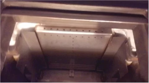

Attached is a foto of the fire chamber, which I discovered has a loose baffle.
The red arrows show the free play because it appears to be missing a bolt (circled).
Is that the case or are these baffles free playing?
Thanks

There is a baffle retaining pin that belongs in there. It's kind of Z shaped so that it can't fall out. The stove will run ok without it but I would have the dealer pull the one in the broken unit that was sent back and give that to you. But check in the parts and firebricks package first.
And those side pieces are supposed to be loose. They just fit into place, if their crooked just straighten them. They should have fancy insulation on the top of them.
Yes, the upper side insulation pieces should lay against the sides of the baffle.
One other thing, the holes for the baffle pin must be exactly aligned or the pin won't fit. The baffle may have to be wiggled into place so the back of it sits down on the secondary air outlet with a fiberglass gasket around it. Make sure the fiberglass gasket material is there. If the the baffle has been removed, the gasket may be missing too. For some reason, mine can be quite stubborn to fit right.

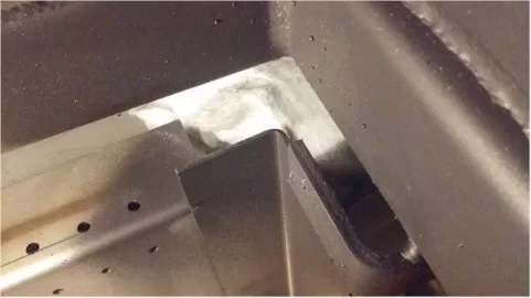

Here is what i have.
The batting/insulation looks to be fine, about a 3/4 to 1" blanket at the tops of the support flanges and overlapping the baffle a bit.
I presume that this is true to factory specs.

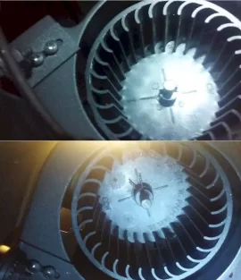

On another note I started up the blowers and noticed a rattle in both.
Look what was sitting in each side!
My guess is that these wingnuts had something to do with the store displaying of the stove as there is nothing else these could belong to right?
One wingnut and washer in each blower cavity!

Also note how only one of the blowers has a "hose clamp" fastener holding the plastic fan on its axle, while the other is missing it.
I bought a similar one at an auto supply store today and now they both have them.
