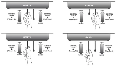

Good tips. I haven't run this stove but am fascinated at seeing that it has a manual, secondary air control. The manual shows the primary air control on the left and the secondary on the right. Has this changed from the earlier version?I have an older version of this stove. The handle on the right controls the air going in the front bottom. The handle on the left controls the secondary air which comes out of the small tubes in the top of the firebox. As others have said, you need dry wood. With dry wood I get very little creosote as long as I don't close the damper in the stove pipe too much. You should be able to see flames coming off of the secondary air tubes which is giving you great combustion and will heat up the top of the stove very well. Once you get the secondary air flames then start closing the bottom air a little at a time. As the stove warms you can keep slowing down air intake, but try to keep the secondary flames going. I can get 4 hours of high heat out of this stove or back it down to medium heat for 6.
Again dry wood is critical. I tried some oak that was only a year old and I had to run it wide open to burn the stuff so I could get dry wood in.
Hope this helps.
