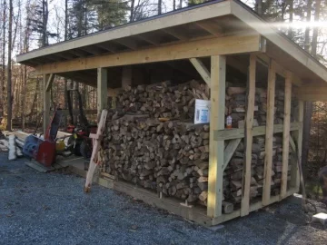

I looked here for ideas on building our new shed. Thanks for all the ideas. I figured I would post some pics of our nearly completed project with hopes that maybe someone else can use them. Now I just need to fill it.
8x20 with 2 foot overhangs.

Good job! At first glance I thought I was looking at my work in progess except that you have a wood floor. Mine is a little deeper & wider but essentially the same frame design.
Now if this rain would just let up I can get my roof on and wrap up this project! Looks like you had some nice weather to work in.

Did you put any type of moisture barrier under the floor?
Non vented floors like that tend to trap moisture coming out of the ground, also plywood floors close to the ground like that often end up becoming critter havens. Personally i would have used open wood slat flooring for both those reasons, but other than that little critique it looks pretty well built. I'm sure it will keep your wood dry.

Very similar to mine, except I used a pallet floor:
https://www.hearth.com/econtent/index.php/forums/viewthread/56894/
I'm in an area that gets some strong winter winds, I tied the roof trusses down with metal "hurricane brackets" & tied the corner post down to a buried pier block
Big roof, big sail. Mine is open on all 4 sides so I figured better tie it down well.
I wish I'd have made more overhang on the back, like yours, water splashes up on the wood during heavy rain. I'm going to add a rain gutter.

That is one well built wood shed. Post and beam frame supporting the roof, open sides and a solid deck. Is that all white wood?
That shelter is coming along nicely! How is the floor constructed, it looks like 2x4's with plywood on top.. The reason is I have 2x6's with only a 6' span and the weight of the wood started to rip out the joist hangers and had to add support directly under the joist hangers before they collapsed.. Definitely a nervous moment!

I built one like that a while back with pt decking for the floor. When it was half full the rim joist broke. I ended up removing the flooring and poured footings under all the joists at 3foot intervals. That worked great. Check the weight of a cord of wood, you will be surprised! You shed will hold close to 8 cords, that is equal to several cars! Unloading the wood and taking up the floor for the repair was a drag.

Thanks for all the replys, questions, and comments. It could hold around 7.5 cords I believe. I am only going to use 2/3rds of it for wood. The last 6 feet will keep the snow off my small kubota.
The floor is 2x6 16" on center with 3/4" treated plywood. The 2x6s are held with joist hangers in 6x6s. Hope it holds up. It is a lot of weight. The only reason I put a floor on it at all is that the 6x6 skids will allow me to drag it and attach to my future garage.
If anyone wants the size specifics, lumber list, etc, just let me know.

I know it's too late now but... some concrete pavers laid under the 2x6 joists would have given a lot of support and taken the load off the joist hangers.
