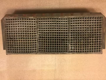

Did you try the distilled vinegar/distilled water simmer?After season 3-4 I noticed a drop off. I replaced the one in my BK this season, it had 5 burning seasons on it. It may have still worked some but it's performance noticeably fell off in season 5.
A few cracks, but looks pretty good. Was the new one you got a DuraFoil? How long has it been in?Here is what mine looked like when I pulled it out.

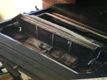

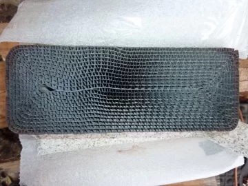

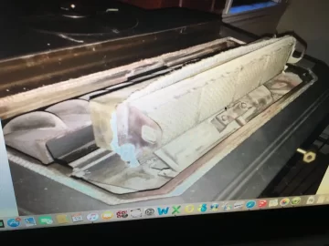

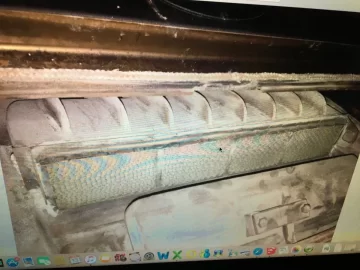

I took everything apart a couple of weeks ago and snapped a picture of the new CAT. I think this is the DuraFoilCAT that you were talking about? The two tab ears don't look like they bolt into anything. Do they have a newer version of this CAT with tabs that bolt in?Good catch! The old diesel-foil cats would warp longitudinally, as well as shrivel slightly, so that they didn't fit well in the Woodstocks' two-piece cast iron cat frame. I was able to flatten them somewhat, then wrap with enough interam gasket to prevent leaking. I never called in the warranty on one, just patched 'em together and got 'em to work.With an open gap, smoke would blow right around the edges. If you went out to look at your stack, you might well assume that the cat was shot. Not sure how the cat is set up on the PH, if @Berner may have had a cast cat frame in his stove. The new DuraFoil cats don't use the frame or interam gasket. They have two tab ears with bolt holes, and you just bolt the cat in using the old shipping bolts that kept the ceramic cats from breaking in transit (in the Fireview and Keystone.)

Sorry for the confusion, I should have mentioned that the bolts were packing bolts that came with the FIreview and Keystone to keep the cat frame and cat from bouncing around in transit, and possibly cracking the ceramic cat. I think the instructions included with your new cat would have mentioned the bolt, if it was applicable in the PH.I think this is the DuraFoilCAT that you were talking about? The two tab ears don't look like they bolt into anything

Yes, that's the new Durafoil cat; See how the rows run straight, all the way across? Here's a pic of the diesel foil cat (this one isn't warped or shriveled.) This is a different (wrapped) construction, no straight rows across. I assume your warped cat was a diesel foil...?
View attachment 190799.
Oops, sorry...now fixed! Yep, that new cat might be a little "hot" for several burns, then should start to settle in.The picture attached doesn't open for me...So far this new CAT has been almost too good.
