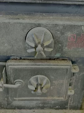

My unit doesn't have a draft blower. There are two mechanically adjusted dampers which are basically round caps on a threaded rod that adjust to tighten against a piece of round tube. I'll add a picture to illustrate. The upper damper feeds directly into the firebox. The lower damper feeds into the ash dump, below the grates. I coming around to agree with you. This unit doesn't seem to burn all that efficiently.

Ah, gotcha...ok so the lower damper is for starting a new fire, and for burning coal...for burning wood close the bottom damper after the fire is established (or very nearly closed) and regulate the fire with the upper one only.
The bottom one can also be used to burn down coals if you ever had a pile that you wanted to reduce some before a reload.
