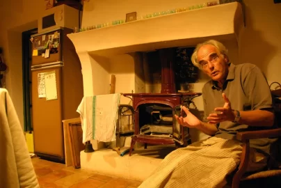

In the mean time - you are most welcome here on hearth.com. Post of a picture of that beautiful install you have there. We love pictures!

Should have mentioned, but I did use furnace cement, the stuff I used to renew the gaskets. As for photos, there is one in the thread somewhere with me sitting rather forlornly beside it...!
