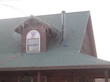

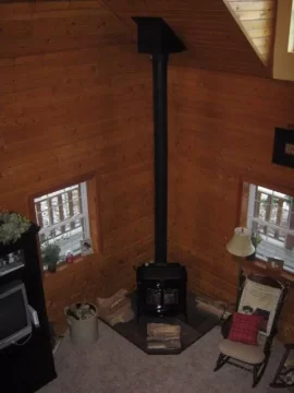

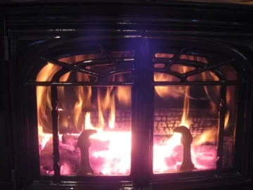

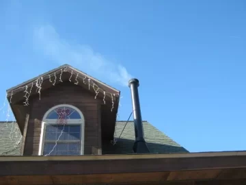

I'm getting her hot. IR gun says 625 on loading lid and 500 over the door. 650 at back of stove. Good coal bed, I think. Temps vary widely on this stovetop. When I close up for a secondary burn, everything looks great inside the stove: syrupy blue flames at the top of the box and popping out of the splits. But outside I'm still getting smell and what I guess is smoke. Still not hot enough? Should there ever be smell? I'm getting six hour burns with a workable coal bed and no sooted glass except some on the sides (first night, yes, I sooted up the glass bad). Learning here ...
