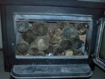

O/S, Have you tried running your stove like this?
You should be easily able to hit 1000 °F on the stove top.

Jimbob, I have it that full but it does not get over about 600 or so (no fan), it seems like I can get a hotter fire with less dense wood and keeping the ashes to a minum but it still likes to "top out" at about 600.
I find that odd. Right now my stove is most of the way through a load of Poplar (not as mich as in the pic), and the Stovetop is sitting at 780 °F and the stack is ~ 500 °F with the air control all the way closed.
To achieve that 600, what position do you have the air control?
I have tried every setting you can think of, I even tried 2X6's backing down the air as the temp comes up, the other thing is my flue temps are high, thought about a damper but not sure that will help, I think I need more draft instead of less. No sure the chimney will fix it but it needs work any way.
I did discover my temp sensor (magnetic single wall) is off above 550 or so but with my IR testor I could easily hit 700 to 800 if I do not keep an eye on it.
That sounds about right, mine will do that, too.
If you were to re-load onto a good bed of coals, open your air control to 1/2 way, let the flue temp get to 800, then back off the air to ~ 10%, what would happen?
Would you get the stovetop temp higher than 600?
