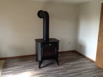

Yesterday I ended up purchasing a Kuma Sequoia freestanding wood stove for the basement, and a PE Summit insert for the first floor fireplace. I have the Kuma in the basement not setup yet, the PE is still in the crate in the garage. Thanks for the input from everyone that chimned in, the info was greatly appreciated. I will keep updates with the installs, and use as time goes on looking forward to using both these heat monsters this fall and winter.
Nice choices. Hook em up, give them dry wood and be comfy.
Can't wait to fire them up!
That Kuma Sequoia looks so good, I love simple designs. Have you figured out either installing heavy duty single wall pipe or dvl?
Single wall pipe to the thimble to a masonry chimney.
