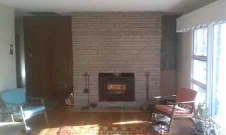

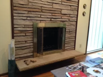

Living room/dining room fireplace: (stacked stone chimney in photos) front width: 34.5" x front height: 30", back width: 30.25" x back height to flue: 35", depth: 24", hearth in front is 16" deep
Living room/dining room is 35.5' x 14.5', with very high angled ceilings (14.5' at highest part) and lots of sliding glass & windows. Chimney is probably around 17' tall.

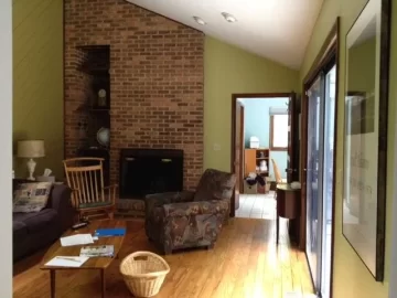

Den fireplace: (brick chimney in photos) Front width: 43.5" x front height: 28.5", rear width: 37.5" x rear width: 37" to flue, depth 23.25", hearth in front of fireplace depth: 20.5"

Our main question is about inserts vs. stoves, in terms of ability to efficiently heat, difficulty/cost of installation, & maintenance. Are there benefits to inserts other than aesthetics? Any suggestions about stove/insert manufacturers & models?
Attaching some photos & a floor plan. We are thinking that circulation should be pretty good in this house, aside from the high ceilings. Any suggestions about doorway fans, ceiling fans, or other methods to help move the warm air around?
