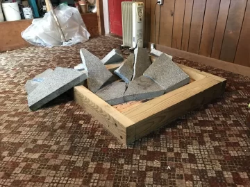

Here’s an update on our hearth. One thing leads to another, we got new flooring since we decided to get a new hearth and wood stove.🙄. Due to the uncertainty of the epoxy and the heat, we ordered a custom made piece of tempered glass. The epoxy is only 1/8” thick, the glass sits down a bit with about a 3/8” space between the glass and the rim of the hearth. We experimented with led lights and decided to order a length to go all the way around. We got some granite pieces (samples from Home Depot) and put felt on the bottom to go under the legs of the stove . The stove is going in on Wednesday, pictures to follow! Plus a bonus pic of one of my Halloween decorations 👻
