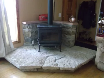

Well its been 5 months and hundreds of hours of work but I am there.. The stove project is complete. I have scaled it back a great deal more than my original concept, in part because of the knowledge and expertise of some here and also due to the fact that my wife wanted a certain look for the room.
The weight of this is held up by a 2 yard footing that is doweled into the footing of the house. Instead of digging more large footings in the crawlspace I poured a pad 12" thick with 5 three foot deep piers and a thickened edge around the outside.of the pad. The rock wall that protrudes into the room is supported by an I-beam where the rest is supported by a series of trussed 4x4's and 2x10's in a similar manner to which I've learned to build decks for pouring concrete, but a little more overkill.

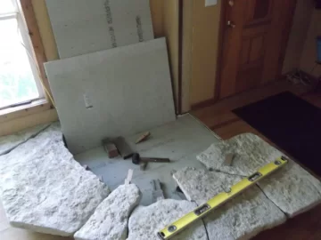

Pic 1 shows were the stove is going after I removed a small partition that was between the dinning and living rooms.

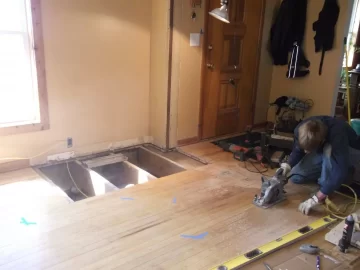

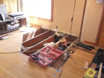

Pic 2 shows the first hole I cut in order to pour the concrete through.(Tried to keep it small for as long as possible so the house wasn't any more torn up for longer than necessary!)

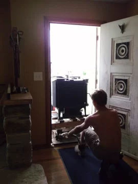

Pic 3 Pretty self explanatory.

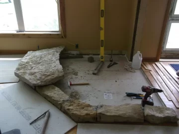

Pic 4 Installing heavy **** I-beam.

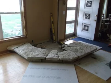

Pic 5 Shows the concrete board I put over the I-beam and 2x10's and the first couple of rocks.

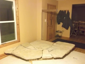

Pic 6 Self explanatory

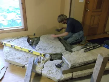

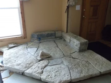

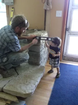

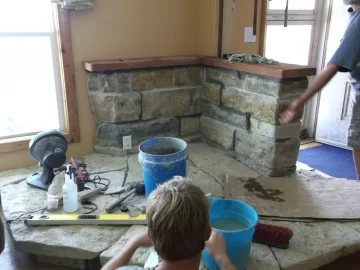

Continue to the walls which took forever. I have never really tried to shape rock like this before so it was a learning experience.
I purchased a few feathers and wedges from trow and holden and a hand held bushing tool. Though I found that rather than use a bushing bit a needle scaler worked better than a bushing hammer leaving less deep bruises in the stone. Also I found that when I was going to split a stone that making a small cut the length of the rock where I wanted it split in order to not have to set the chisel each strike saved a lot of time.
I made the edge of the wall near the window taper back at a 45 degree angle which made splitting those stones time consuming. Depending on the location and shape I was trying to make some of the stones took as much as 8 hours to get to the perfect shape.(The wall that was exposed on both side was #ell to shape. And it really got your goat when you had 4 hours or more in and the stone cracked where you didn't want it to.) You can say I had a very personal relationship w/ each stone. If you were to point to a stone on that wall I can tell you the original size, shape and area where I found it.(As I went around to farmers fields and ditches and found and loaded up all those heavy suckers by hand.)

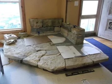

The 3rd pic shows my super hero helper son. He's really the one that moved all those heavy stones for me;-)

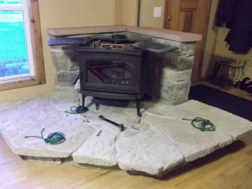

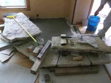

The 4th shows me utilizing the 2x4 that was part of the old partition that I was glad I didn't take out b/c I would have had a heck of a time setting those heavier stones on the grout evenly.

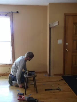

The 5th shows the flag stone I used for the mantle. I found it from a person that owed our family some money so traded him for funds due. It is supposedly from Arizona but I wouldn't know for certain. I just know I liked the looks of the stone. I used a skill saw w/ a diamond blade and a pump up sprayer wired to the guide to cool the blade. That stuff cut extremely hard.
