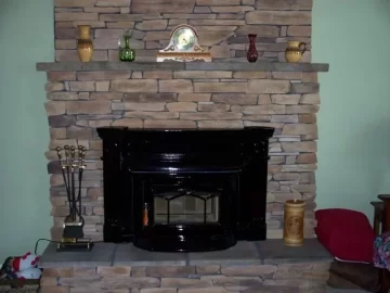

Finally got it installed today. I want to thank all the Hampton owners that offered advice for the last 8 months. I would appreciate any tips on how to get max potential. I am really surpised on the lack of noise even in high mode this thing produces. The fan doesn't seem too powerful. My old stove has a fan on in high mode you can't even hear the TV. Thanks again

Is he at all related to Max Headroom? Sorry! If you couldn't hear your TV before, you'll have no idea to whom I referring. No answers for you, except burn the driest (most seasoned) wood you can, and if you have access to good hardwood, choose that. Low, smoldering fires are bad (creosote formation in the stovepipe/chimney). But, I imagine you already know all this. You'll get to know your new setup as you begin to burn in it. It's really pretty, enjoy! Rick
Beautiful. All set for a warm house this winter.
Get it hot, load it up, and choke it down. The temp will climb! When using seasoned wood put the thermometer (you would have asked anyway ;~) ) on the top "shelf." If I remember right running it so that the temps there hit 225-350 is the sweet spot. The heat (snap disc) that controls the auto on/off will probably need to be bent out slightly to properly contact. You will need to pull the blower out to get to it. More will come to me but off the top of my head those are the things I encountered and others after me. BTW nice setup! Mine is very similiar with a 6 1/2 foot oak mantle instead of the stone. Get your wood now and enjoy the WARM house this winter!!!

That's a sharp looking installation cocey. I'll bet you're just itching for a cool night now.

beautiful stove those are beautiful ... if my house was smaller best believe i would have one and prolly never pay attention to the wife
Thanks guys. Yeah, I have been stockpiling wood for the last year in preperation. I can't wait to use it. The wife likes it but the first comment out of her mouth is " its very shiny".

Sweet looking install. My biggest suggestion is to teach the other half how to go fetch wood. ;-)
I think the Hampton inserts are about the nicest looking stoves I have seen, and the quality looks like it's also the best. And then the price also reflects this as well. I hope they burn as clean as they look.

Enjoy! I love the stone hearth.

Very nice, did you have a block off plate installed, this has made a difference for me and was a major PIA to install after the fact. Assuming you have done some searches for tips on forum, they are buried in threads but there. Agree on comment to get a few smaller burns in while the house has plenty of windows open.

No on the blockoff plate. I couldn't get anyone in the area to even consider doing it. Most of the people that I talk to said it was unnecessary. I think thats crap but I wanted this particular stove. Most didn't want to deal either. I finally got a decent deal (the fan for free) after waiting 9 months. If the Hampton wasn't so pretty I would have went looking at other brands long ago.
