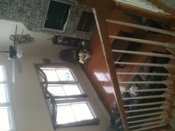

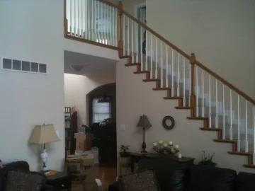

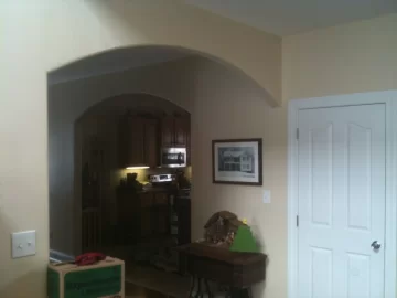

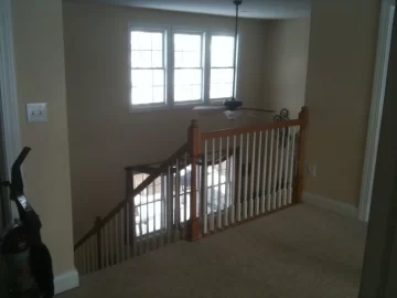

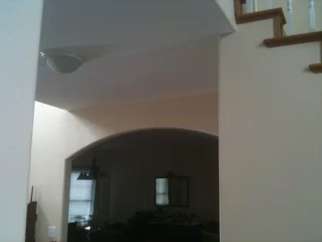

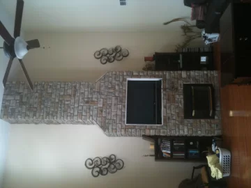

hey guys. i'm still here. lol I work some crazy hours and have been doing as much research as I can on woodstoves, etc... which is how I roll. Obsess over something until your head pops off which is where I am headed...lol anyway, thanks for all the input so far. As I said I think we have decided on a wood stove. now which brand? I like the steel stoves best I think. looked at Lopi Liberty, Country ST310 models such as those. so if I am heating 2000sq ft. is it wise to get one that does 2000 sqft minimum? or is this overkill? the ST310 will do 2000-3500 so will it "overheat"? also i have archways in between some rooms, will that kill my heat transfer from room to room? and as if that wasnt enough how about more questions! lol cat or non cat? I understand the science but have heard cat stoves don't last as long and are more expensive to maintain....when i started this i was thinking throw some wood in a box....now I know why there are forums...lol thanks in advance! i'll post some pics if i can figure out how. :-)
[Hearth.com] New guy...would love input. [Hearth.com] New guy...would love input. [Hearth.com] New guy...would love input. [Hearth.com] New guy...would love input. [Hearth.com] New guy...would love input. [Hearth.com] New guy...would love input.
hey guys. i'm still here. lol I work some crazy hours and have been doing as much research as I can on woodstoves, etc... which is how I roll. Obsess over something until your head pops off which is where I am headed...lol anyway, thanks for all the input so far. As I said I think we have decided on a wood stove. now which brand? I like the steel stoves best I think. looked at Lopi Liberty, Country ST310 models such as those. so if I am heating 2000sq ft. is it wise to get one that does 2000 sqft minimum? or is this overkill? the ST310 will do 2000-3500 so will it "overheat"? also i have archways in between some rooms, will that kill my heat transfer from room to room? and as if that wasnt enough how about more questions! lol cat or non cat? I understand the science but have heard cat stoves don't last as long and are more expensive to maintain....when i started this i was thinking throw some wood in a box....now I know why there are forums...lol thanks in advance! i'll post some pics if i can figure out how. :)
View attachment 126894 View attachment 126895 View attachment 126896 View attachment 126897 View attachment 126898 View attachment 126899
Don't feel bad I knew nothing when I started researching and I took around 3 months looking around before I decided I wanted a cat stove. Then another few weeks before I went with BK. These are a long term item. You could very well be using it 20 years from now so making sure you will be happy with it is key IMO.
