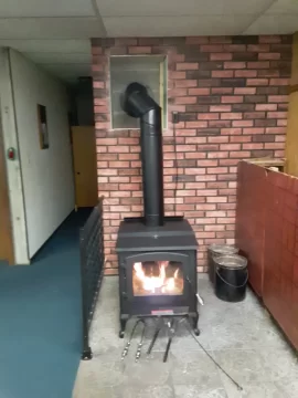

I'm burning ash that was 15-18% in the fall on a fresh split, so it is seasoned. I burned all the 20-25% when the smoke dragon was still in. Another day of experimenting makes it look like Mark may have been right. I've since let it go higher (up to 660) without the smoke detectors going off and let it get to 450 like he said before starting to choke it down. The heat and length of burn time is AMAZING! Takes forever to burn the coals down to ash to drop into the drawer though. I'll keep watching the wind and experimenting with the air control accordingly.
I've attached a photo of the install with a fresh one lit.
