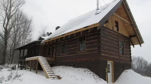

As I said I just built my addition 4 years ago. It is a very well built log cabin with R 44 in the ceiling.
Expensive insulated windows, they cost $700 each.
I know it gets a lot colder in Montana than it does here.
If I were you I would go with R60 in that ceiling.
