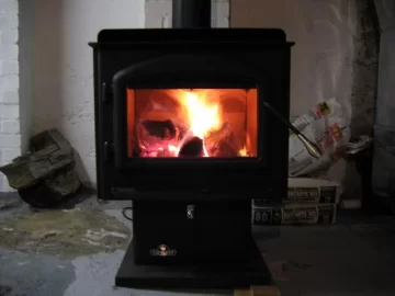

I purchased the Napoleon 1400, pedestal version. Couldn't be happier. 2000sq ft home, 90 year old Victorian and not exactly perfectly energy efficient but reasonably insulated. It can get chilly around here (Colorado... right now is below 10 degrees and has been -15 a few times this year as well). It took a few days to go on a shakedown cruise, but once I got familiar with the stove, it has been great. As someone mentioned, it is utilitarian, nothing fancy, but instead of $250-$300 gas bills, we are below $30 for the water heater mostly.
And it seems to burn fairly efficiently as well. It has a secondary burn and when you get a nice bed of coals, place two or three splits on them for the night, and things are humming along, it is beautiful to watch the flames lick the top of the stove and have the secondary burn light up the gasses at the top. I have just 'discovered' pinon for myself, and I can place a pinion split and an oak split in at bedtime, and it will still be heating the home 6-8 hours later easily. I am very happy with the stove. It works well for me. At first the only thing I didn't like was the ash pan delivery system... a little too small to scrape ashes into the small opening. But I learaned how to burn efficiently, and how to cycle ashes up onto burning wood, and I have not had to clean the firebox out in two weeks. Paid $750 for the stove, new, and $195 for the door, new. A happy Napoleon camper.
