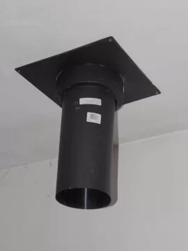

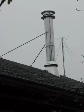

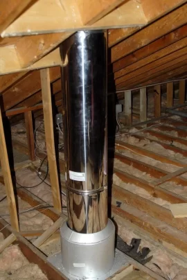

Maybe I can snap a few "complete" pics.
Pics of the finished install

That looks good. Very similar to what I'm doing.
Thanks.
