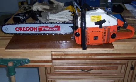

I was having trouble with my saw binding up in the cut. but run fine free. After nursing/fighting it thru the spruce tree, I took it to the shop.
1. the sprocket was almost cut into (old style " Spur sprocket" ) (It lasted over 20 years)
2. the bar was worn bad from the chain right where it leaves the sprocket (over .070)
3 The chain got hot, worn & stretched & dug into the worn sprocket to where I was out of adjustment.
Fix:
. I was able to find a local Oregon dealer & got a new bar, Oregon Pro -Lite, 3/8 X .050 - 20"
. A new chain 72LPX with all kinds of new features my old chain didn't have. better oil retention, witness mark for sharpening, made for dirty conditions, cold weather steel etc.
. A new style sprocket, Power Mate Rim Sprocket, 7 tooth, with replaceable "Rims" (I wonder if a 8 tooth would increase chain speed??)
Anyway the old Husqvarna 61 is back in business, will find out tomorrow if all this "High Tech" parts will cut wood.
Found this site for Oregon chains, bars sprockets & more. Several kinds of chains & bars for specific types of cutting needs.
More to know about chain selection than I knew.
Select your saw brand, then model, bar length, chain specs.
(broken link removed)
  • [Hearth.com] New Chain, Bar, Sprocket & more

OH MAN!
What a difference. When I had the saw apart, I even cleaned the air filter.
Straight cuts. Fast cuts. No binding in the cut. Big chips flying out.
Used less gas. Idled better. (Maybe something to do with clean air filter)
Any way, it worked great, cut like I remember.
So every now & then a little maintenance should be done. I read the "owners manual" & I'll be doing better at maintenance.
It was just nice to zip through some 12" birch. :)
