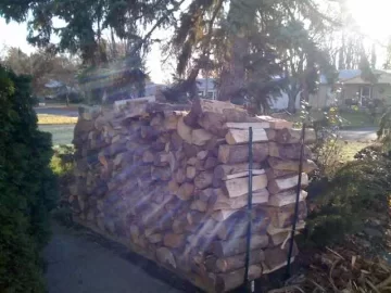

  • [Hearth.com] New Burner Questions & City Dwelling Burners?
