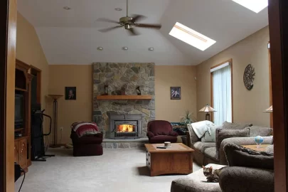

One I would consider for this spot is the Jotul C550 Rockland. Excuse the crude Photoshop job, but here is the idea.
