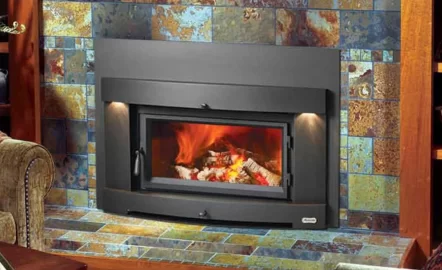

I'm interested in the contemporary look. It so new no one has it in the showroom yet.
Any up front critique?
My first quote was 3200.

Good lookin insert, big fire viewing but I don't like the plain looking surround.
I hear you but every insert has something "wrong" with it.

I like the clean look, but they can keep the loading dock lights.
I just like the contemporary look. Dealer is getting one buy the end of this month. I want to touch it.
I think it looks great. Huge glass, modern and clean. The only beef I have with it is the depth of the firebox. It is no good for NS loading, and that makes a big difference. At least that has been my experience.

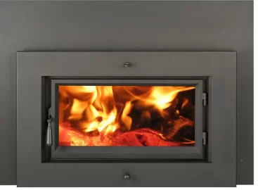

There is another version that is only shown on the Aussy site. It's a flat face version without the lights. Lopi's USA site only show 3 Insets. What's up with that?

I'm confused. They are all made in the US.
I guess they mix up the stoves in Australia a little differently. I didn't see the flat look Flush on the Avalon site, only as a Lopi in Aussy.
