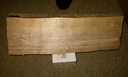

How many times,The wood is DRY!!!!!!!!!!!! can you not see the numerous cracks in the ends of the wood, Split wood is seasoned in woods under cover for a year, we mark our piles accordingly. The wood is then put in the woodshed behind the stuff left over from the previous year or years.
At this time we have several cords of wood in the shed left over from last year and a few iron wood logs from several years ago. Plus several cords designated for this heating season that will actually be used next season or after 2011-2012. Provided previous years are used first! We keep our piles of wood labeled, but right now we are at around 2+ years after splitting and most of that is under cover in the woodshed. Plus the year in the woods cut to length and the tree was dead in the first place.
The wood in the photos I will not be needing until Feb at earliest I could have used it in Fall 2010 (1.5-2 yrs split seasoning). I have 2.5 cords in garage left over from last year I need to go through first, I just need these for all nighters. I also have 1.5 cords of Oak here at home for 2011-2012 so that keeps even more wood in the woodshed that will be available in years to come. We always have dead trees to cut. The wood pictured is for my stove the Lennox Montecito very efficient.
I had no idea how much wood we would need when I bought the stove so I did not want to empty the woodshed of stored wood so I bought some wood last year plus our own wood. I wish I hadn't wasted my money. The 2 cord of wood was short by almost 30% and lousy tiny pieces. Who splits a nice oak log into 2" square logs. Anyway, I had a total of 4.5 cords at house and only used 2.5 so I did not use any of the purchased wood. Now I am using it this year and it burns lousy I constantly have to feed the fireplace with wood with those tiny pieces of nice oak,ash and cherry logs.
Easy there. Calm down. It was a simple question. Based on your initial posts, it sounded like you left the wood in the round for one year and then split it when you needed it. You have to understand that probably 95% of the problems diagnosed here end up being the wood. You'll indulge us if we start and focus there first.

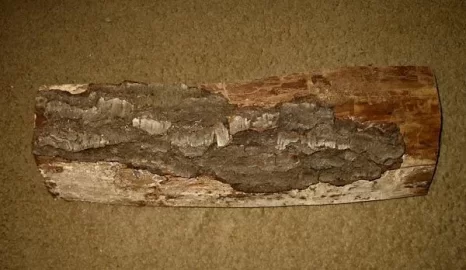

I am a bit confused. One of your earlier statements said you won't sell wood that has lost it's bark that should not have lost it's bark.
Any wood I have ever cut, split and stacked has lost it's bark after seasoning. Not all, but the majority.
Maybe someone knows better than me, but what woods are supposed to hold their bark when seasoned or dry? I would think as it is dead, it would lose its bark?
Just curious.
Just curious.
Ash trees hold bark so do cherry even when they start to get pulpy on outer layers. Although sometimes they don't. Here are 2 samples I dug out of my stack. The cherry was cut dead several years ago I would guess about 4 yrs ago. Then stored split in woodshed for about 1 yr, because I have had it in my garage for 2.5 yrs now. The bark that is off parts of the log because it came off during me digging it out from behind the wood I brought home in Spring 2008. It is still very solid though.
The maple is just loosing it's bark and was cut about the same time I guess since it was just under the cherry. The bark would probably peel right off I tried to, wood is still solid though.
You are right though most of the logs do lose their bark so we do have a hard time getting that good looking log to sell, some people are very picky about their wood they burn up into ashes. We have boxes and boxes of bark that we use for fire starters.
