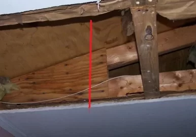

I did end finding out that the 1/2" plywood sheathing did run 96" up from my eaves, so I was able to anchor the support brackets into some solid stuff with some washered fine thread metal roofing screws. I did want to anchor the cricket with the same screws plus a poly urethane caulking. No urethane caulk was availible in my area and I found i had to travel 60 miles round trip to get some. So i settled with 12 washered screws into the metal and sheathing and filled the gaps with a caulking called BIG STRETCH. I have never used this brand of caulking before but was advised at the local lumber yard that it was good stuff. It's pure crap. It had still not set up in the heavier caulked areas after 2 days. At least I have good support with the screws and this caulking may decide to harden....but I'll never use it again. Perhaps if it fails...In the spring I will scrape it out and replace it with sono-lastic or PL Urethane. The motto of this story is stick with the materials that you are sure about and don't take just anybodies word for the efficasy of any untested product.....Untested by you
