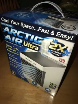

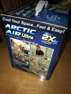

Hello
I have seen this evaporator cooling technology around for many years and you can find plenty of Make your Own on you tube.
This year for only $40 bucks you can get one at Home Depot! The checkout girl got one and she said it is definitely better than just a fan!
Do you have one? What do you think?
Here is a good write up.
Fresh Air: The revolutionary new air conditioner
New Home Depot unit called Artic Air!
ARCTIC AIR Ultra 677 CFM Compact Portable Evaporative Air Cooler for 45 sq.ft.-AAU-MC4 - The Home Depot
They say to put the filter in the freezer for extra cooling power!

Evaporative coolers (AKA swamp coolers) really do not have a lot of use in New England or coastal areas for comfort cooling as they only work in areas with a big difference between the Dry Bulb temperature and the Wet Bub temperature. Great for an arid desert climate, not so good where on hot days the relative humidity is high. The benefit of precooling the evaporator pad is pretty minimal or could be negative if the device used to cool the pad (like a refrigerator) is inside the same space.
Its tough to see how marketers sell crap to poorly educated folks who are desperate for a bit of cooling in hot weather.

High school physics: how can it simultaneously consume energy, and remove energy (heat) from the room? This is not that far from folks thinking you can cool a room by leaving a refrigerator door open.
The only difference here is that by evaporating water, an endothermic reaction, there is some small amount of energy (heat) consumed in that process. But generally, unless you live in a desert, humidity is the last thing you want to be pumping into your house in summer.
